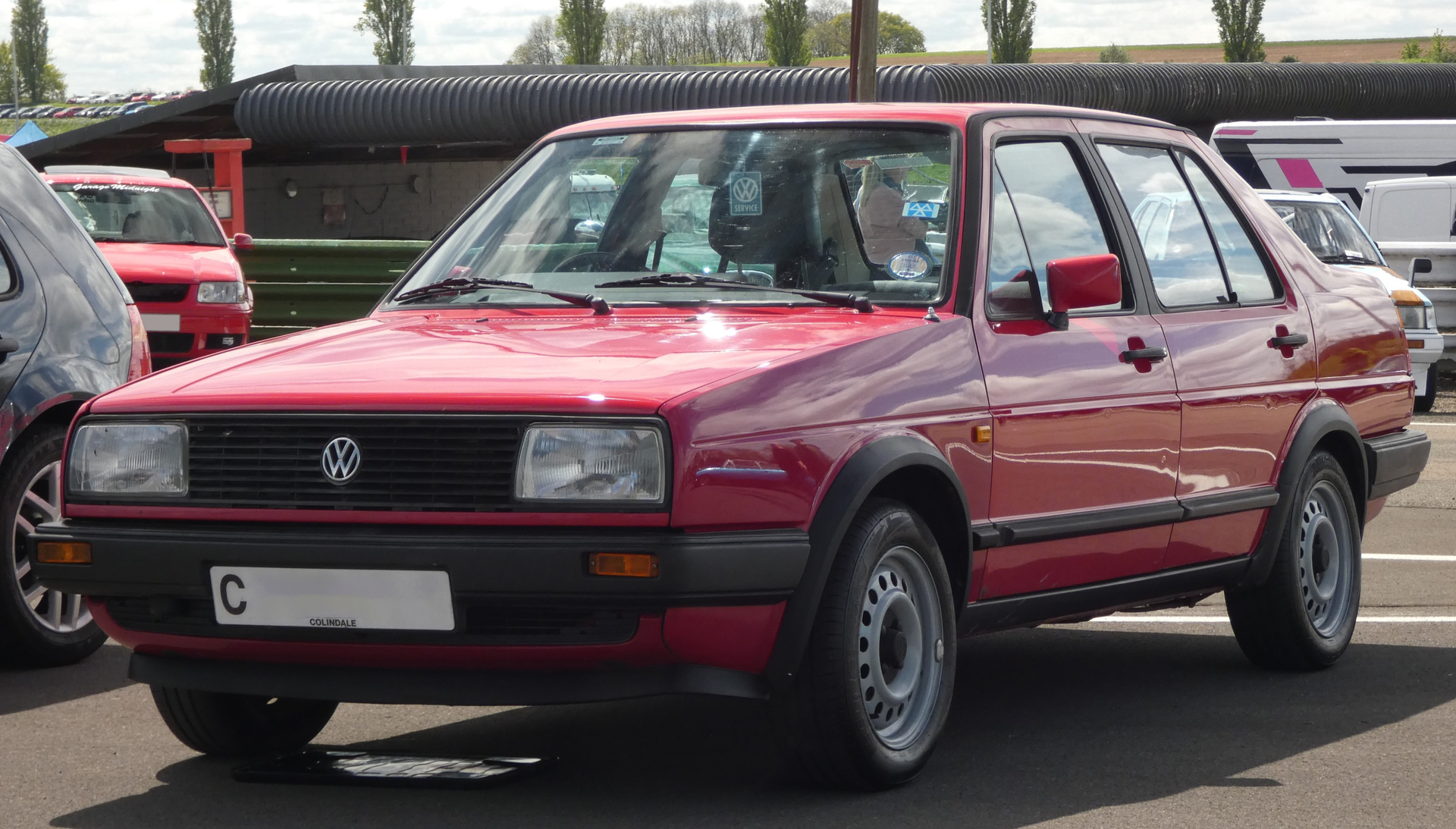

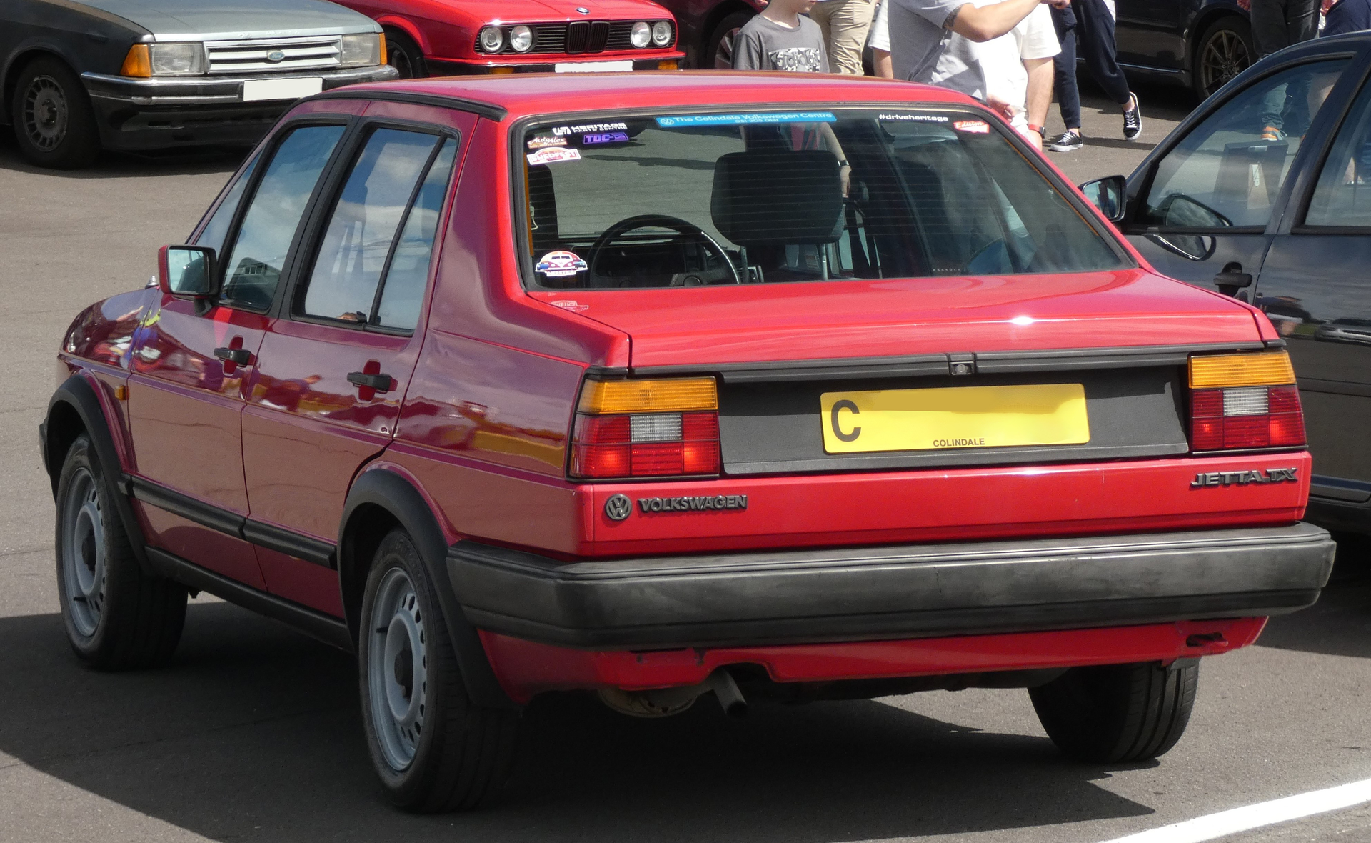

πŸ‡©πŸ‡ͺ Volkswagen Jetta MK2 TX before facelift (1984 - 1987)
▢️ 1. Main ◀️
  • Class: C
  • Body type: 4-door sedan
  • Drivetrain: FWD
  • Length: 4346 mm
  • Width: 1660 mm
  • Height: 1410 mm
  • Wheelbase: 2475 mm
  • Front wheeltrack: 1427 mm
  • Rear wheeltrack: 1422 mm
  • Ground clearance: 130 mm
  • Basic tire size: 155/80 R13
  • Optional tire sizes: 175/70 R13; 185/55 R15; 185/60 R14; 195/50 R15; 205/45 R16
  • Front brake type: disc
  • Rear brake type: drum
  • Front suspension type: independent, Macpherson struts
  • Rear suspension type: semi-independent, torsion beam
  • Own weight: 910 kg
  • Number of seats: 5
▢️ 2. Engine ◀️
  • Model: 1.6
  • Produced: from 1983 to 1992
  • Displacement: 1595 cmΒ³
  • Engine power: 75 HP (55 kW) at 5500 rpm
  • Maximum torque: 125 Nm at 2500 rpm
  • Number of cylinders: 4
  • Number of valves: 8
  • Compression ratio: 9.0 : 1
  • Bore Γ— stroke: 81 Γ— 77.4 mm
  • Injection type: Pierburg 2E2 carburetor
  • Ignition type: electronic
  • Maximum speed: 165 km/h
  • 0 - 100 km/h: 13.4 seconds
  • Engine code: EZ
