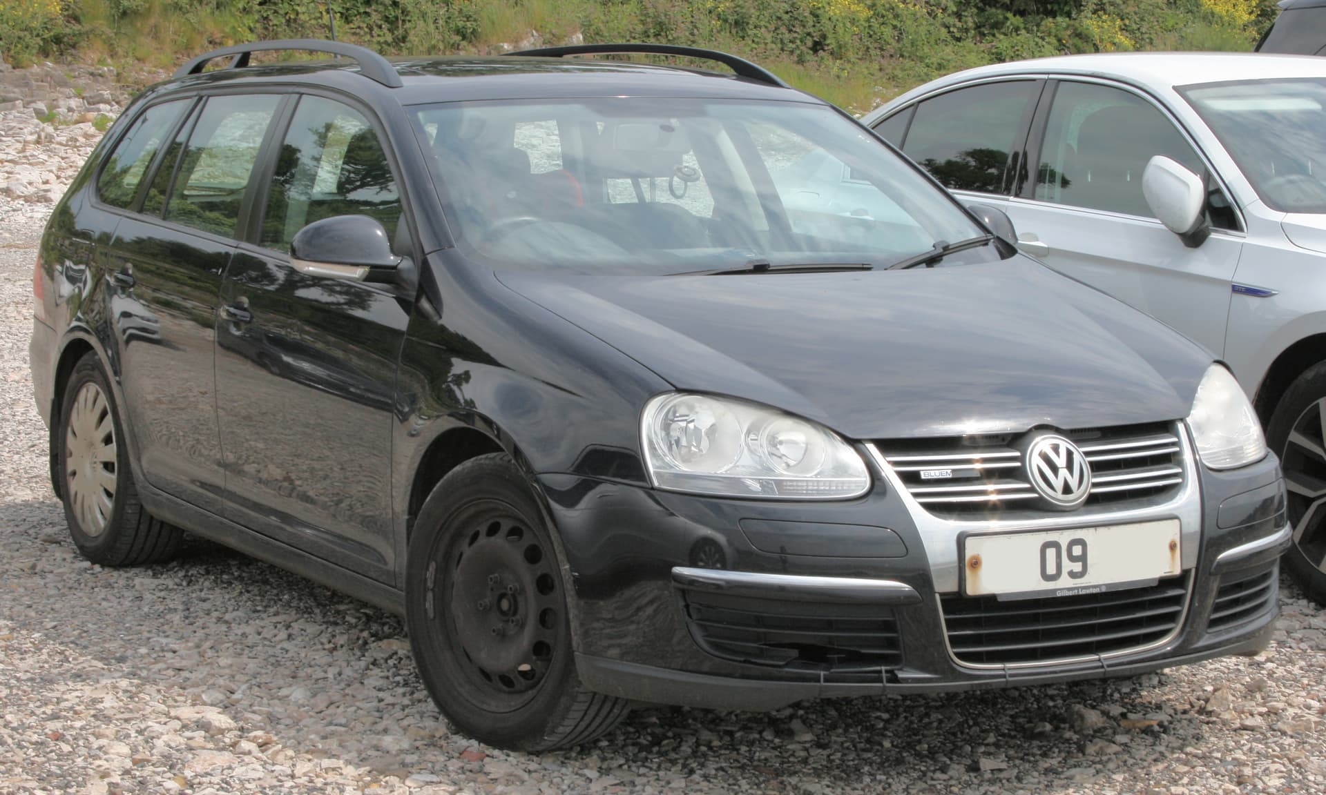

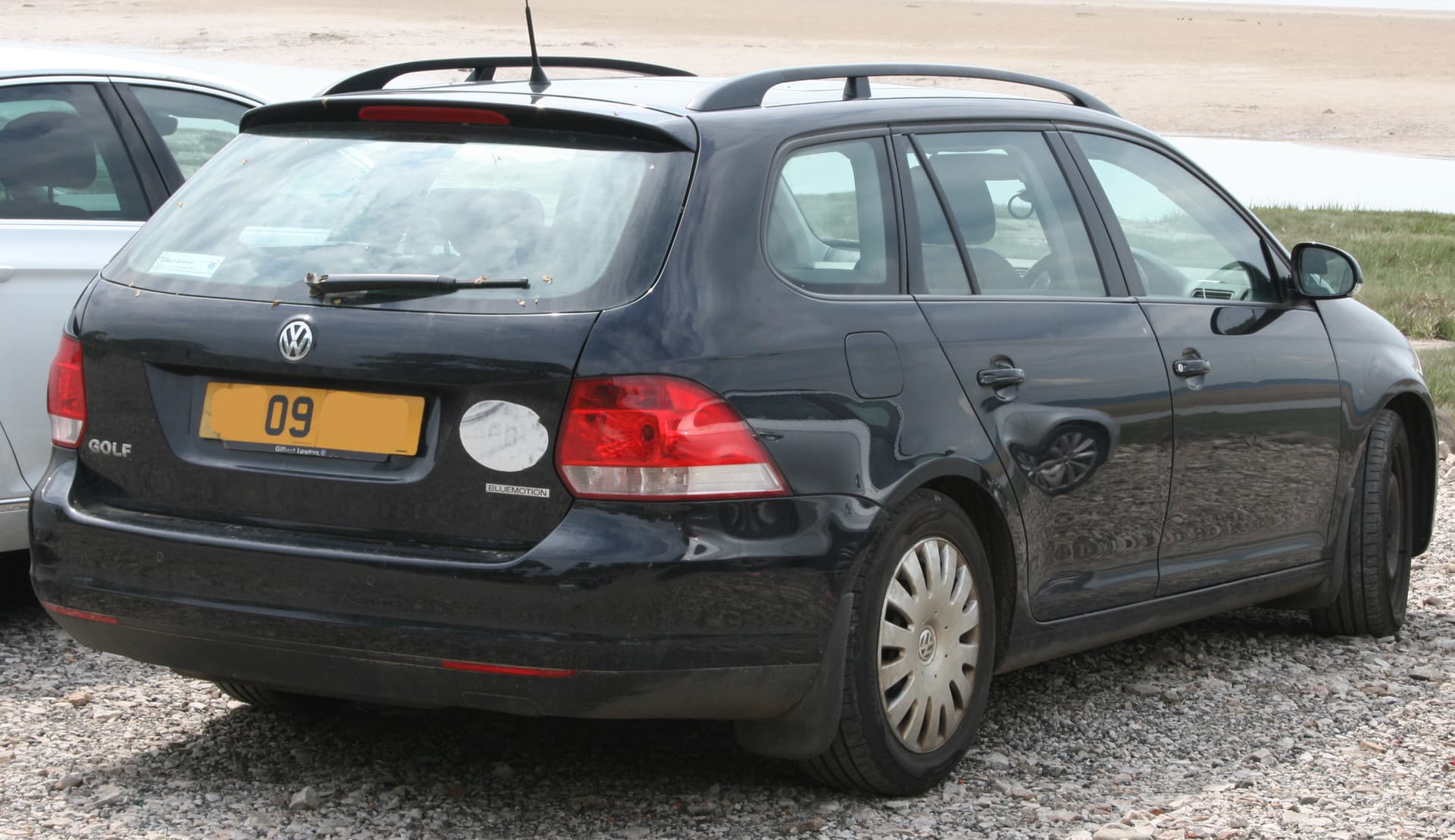

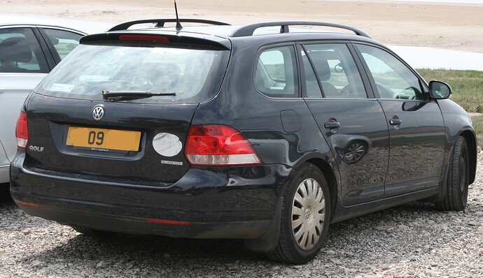

πŸ‡©πŸ‡ͺ Volkswagen Golf MK5 Variant (2007 - 2009)
▢️ 1. Main ◀️
  • Class: C
  • Body type: 5-door wagon
  • Drivetrain: FWD
  • Turning diameter: 10.8 m
  • Turning radius: 5.4 m
  • Length: 4556 mm
  • Width: 1781 mm
  • Width with side mirrors: 2003 mm
  • Height: 1504 mm
  • Wheelbase: 2578 mm
  • Front wheeltrack: 1535 mm
  • Rear wheeltrack: 1508 mm
  • Ground clearance: 146 mm
  • Approach angle: 13.6 Β°
  • Ramp angle: 8.8 Β°
  • Departure angle: 11.9 Β°
  • Tire size: 195/65 R15
  • Front brake type: ventilated disc
  • Rear brake type: disc
  • Own weight: 1361 kg
  • Number of places: 5
  • Euro NCAP test rating: 5/5
