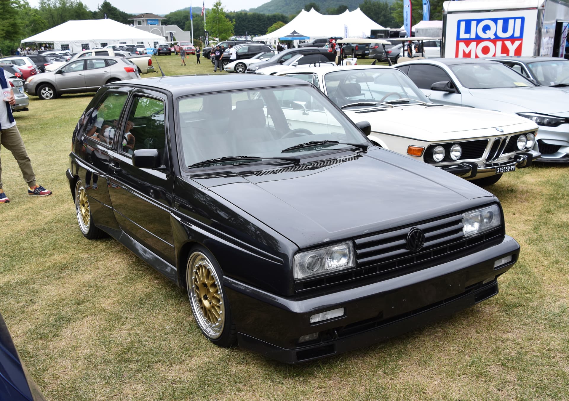

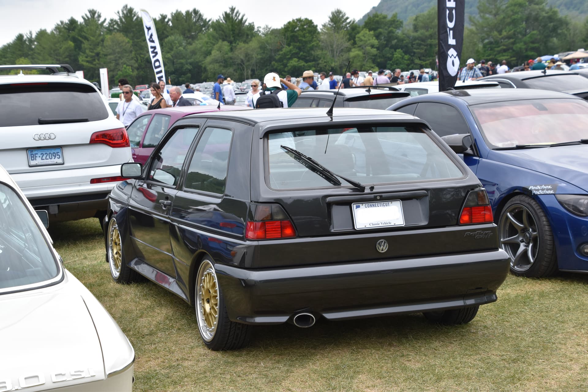

πŸ‡©πŸ‡ͺ Volkswagen Golf MK2 Rallye (1989 - 1991)
▢️ 1. Main ◀️
  • Class: C
  • Body type: 3-door hatchback
  • Drivetrain: AWD
  • Length: 4035 mm
  • Width: 1700 mm
  • Height: 1415 mm
  • Wheelbase: 2470 mm
  • Front wheeltrack: 1435 mm
  • Rear wheeltrack: 1437 mm
  • Steering type: Rack and pinion with hydraulic power steering
  • Tire size: 205/50 R15
  • Rim size: 6J x 15
  • Front brake type:Ventilated disc
  • Rear brake type: Disc
  • Front suspension type: Independent McPherson strut, anti-roll bar
  • Rear suspension type: Anti-roll bar, trailing arm
  • Own weight: 1195 kg
  • Number of seats: 5
