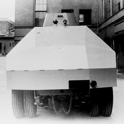

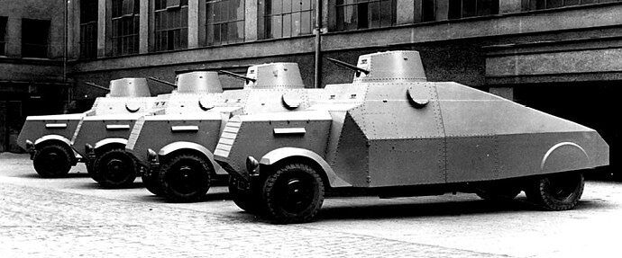

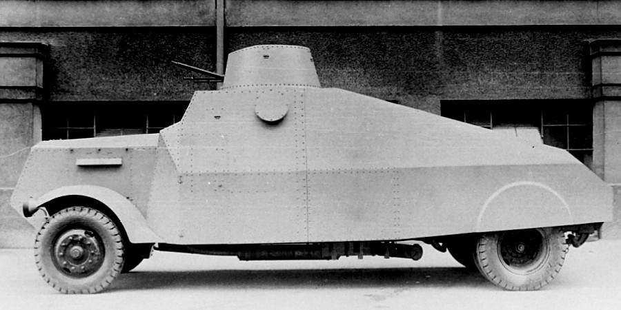

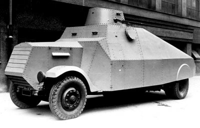

TN SPE-37 1937
- Engine: In-line, 6-cylinder, water-cooled petrol engine with a cylinder capacity of 7,793 cm³.
- Maximum power: 104 hp at 2,000 revolutions per minute.
- Gearbox: 4-speed, identical to that of the TN SPE.
- Top speed: 50 km/h (thanks to the more powerful engine).
- Chassis: Prague TN
- Range: 250 km.
- Dimensions and weight: Identical to those of the TN SPE (length 7,985 mm, width 2,200 mm, height 2,650 mm, ground clearance 250 mm, weight about 12,000 kg).
- Body material: Armored sheet metal and regular sheet metal.
- Armor: Similar to TN SPE, 4 mm armor for the engine and combat compartment, 8 mm armor for the turret.
- Body shape and tank: The tank has been extended and tilted rearwards for better visibility from the turret, which has increased its capacity by 200 liters.
- Armament: Identical to TN SPE – water cannon with a capacity of 2,000 liters/minute under a pressure of 30 atm, ZB 30 machine gun (7.92 mm caliber, with 1,000 rounds), six 100 cubic meters tear gas cylinders and 100 tear gas hand grenades.
- Additional improvements:
- Portholes with bulletproof Tryplex glass for extra protection.
- Fan mounted in the left side wall for ventilation of the combat space.
