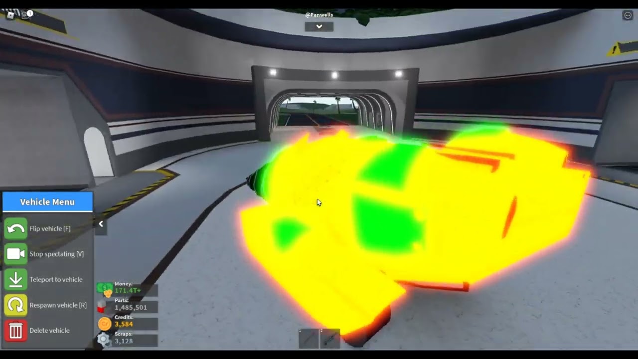

In one instance, I joined a server just after the core detonation explosion, and was able to spawn my vehicle before the rest of the server was teleported back to the facility.
  1. Spawn a vehicle during or immediately after a core detonation explosion
  2. Game will remove player from vehicle as part of teleporting every player to the spawn location, but vehicle remains spawned
  3. Spectate vehicle and attempt to zoom in and out or use the movement keys–camera will behave strangely. Glitch with camera getting stuck doesn’t always occur, but behavior is abnormal.

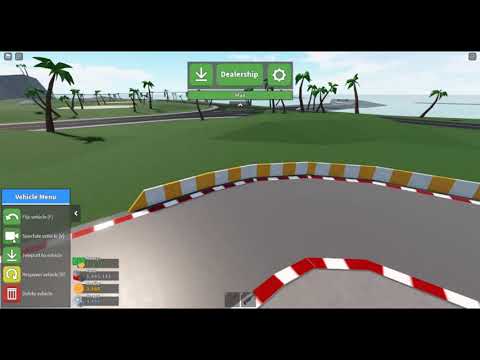

In a different server, I was in the stunt race and destroyed my vehicle by landing a jump upsidedown. After respawning said vehicle and finishing the race, any subsequent spectate vehicle toggles teleported my camera to the currently-spawned vehicle like normal, and then returned my camera to the location at which I respawned my vehicle during the race.
  1. Have your vehicle be destroyed during a player-triggered instance of the stunt race; respawn and finish the race
  2. Spawn a new vehicle and trigger the spectate vehicle camera, then trigger it again to disable it. If the glitch has occurred, the camera will return to the location of the destroyed vehicle instead of returning to focus on the player. The camera may also turn or move around when the player uses the motion keys (WASD or arrows).
UPDATE: I have recreated the bug in a 2nd run of the stunt race. I used the “Pagassi Zena Ciqano” and went too fast into the corner barrier seen in the video, damaging the front wheels and forcing me to respawn. Upon completing the race and returning to destroying the “Panzer VIII Maus” for parts, toggling the spectator camera view took me back to the same glitched corner view. Respawning the vehicle and resetting my character helped fix it again, as seen in the video below.
Separately, the link between respawning a vehicle and/or selecting a new vehicle is reinforced by the fact that my spectator camera was moved to the location of the “Tessel Cybermech” I used in a player-initiated quarter-mile race. I drove into the water after the race and was inside that car when I accessed the dealership to spawn the vehicle I was destroying before the race; toggling the spectator camera took me back to the location where the “Cybermech” was despawned.

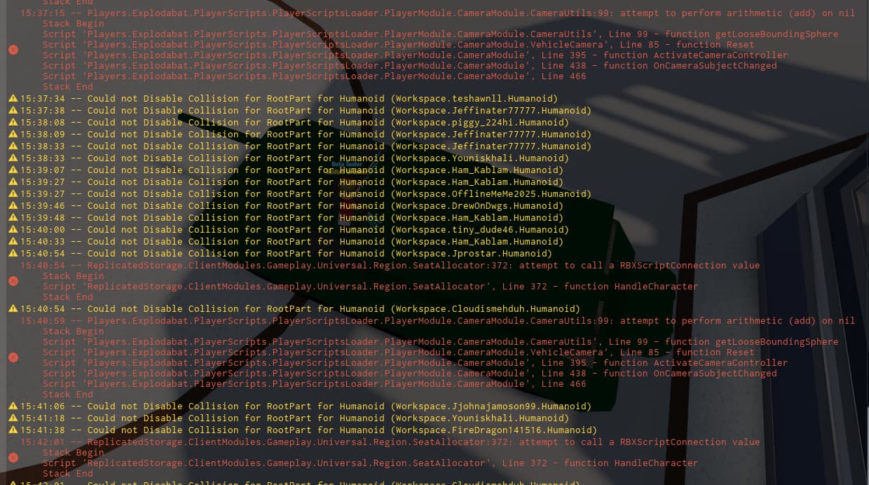

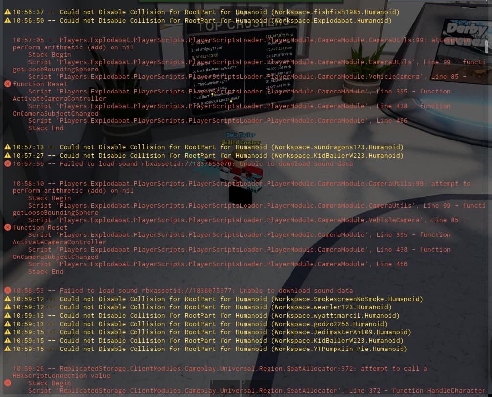

Upon repeated attempts at races, the initial appearance of the “cameramodule” error message is after a vehicle is spawned after ending the race. I have tried multiple different vehicles, so I do not believe it is solely the fault of the Panzer, but given that said tank has had camera issues before, it may be a factor? I have attempted spawning the tank in new servers outside the context of a race, and no error appears, so the race or other events do appear to have some sort of impact on the bug.
Yes/No: Yes
Please see the video recordings of the bug occurring for the full console errors; only snippets of suspected related error messages are attached below due to the significant amount of yellow and red text that needed to be scrolled through.
The errors I saw the second time around (“UPDATE:”) appear to match up to those observed and pictured in my originally-posted screenshot:

Spectator camera glitching and returning to racetrack
Error console open at the same time the spectator camera is toggled:

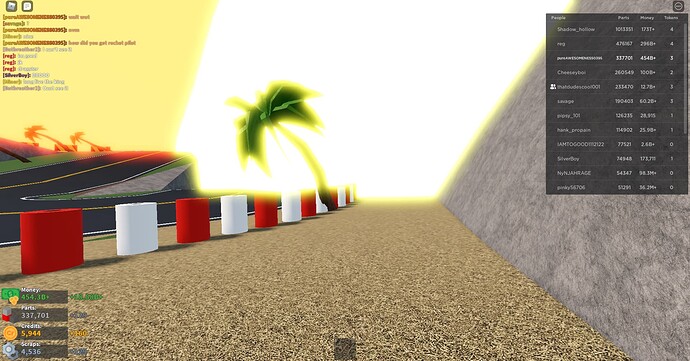

Answer: the camera is stuck where you last had your car when you spawn a car out of dealership after completing a race, and when core exploded, camera teleported there
