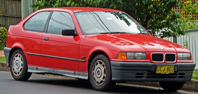

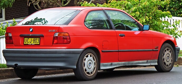

πŸ‡©πŸ‡ͺ BMW Series 3 MK3 E36 Compact before facelift (1993 - 1997)
▢️ 1. Main ◀️
  • Class: C
  • Body type: 3-door hatchback
  • Drivetrain: RWD
  • Turning diameter: 10.2 m
  • Turning radius: 5.1 m
  • Length: 4210 mm
  • Width: 1698 mm
  • Height: 1393 mm
  • Wheelbase: 2700 mm
  • Front wheeltrack: 1420 mm
  • Rear wheeltrack: 1425 mm
  • Ground clearance: 125 mm
  • Steering system type: Rack and pinion with hydraulic power assist:
  • Basic tire size: 185/65 R15
  • Optional tire sizes: 205/55 R16; 205/60 R15; 225/35 R19; 225/40 R18; 225/45 R17
  • Front brake type: disc
  • Rear brake type: drum
  • Own weight: 1140 kg
  • Number of seats: 5
  • Euro NCAP test rating: 2/5
