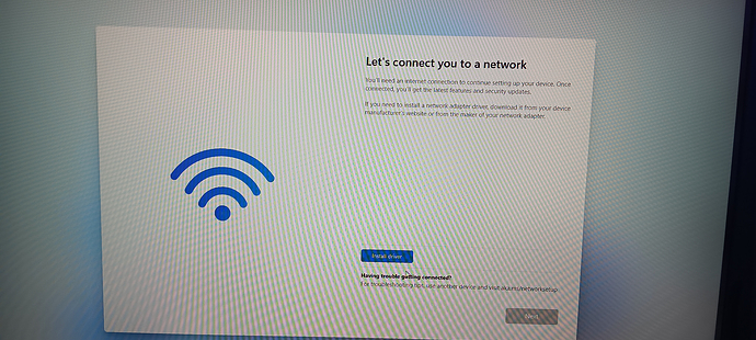

And after finishing with the OS you also have to install drivers so bluetooth and wifi works
You need to find the exact model of your motherboard on the manufacturers website and download it from there

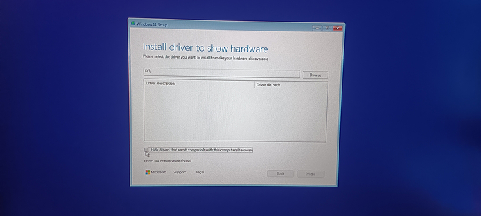

Ok, I’m stuck. I have a disk drive, I’m trying to install windows 11 with a disk that has cost me $100 and this is where I am…
I’m in pain…

Wait a minute, your new computer was in Windows 7?
Ok, now I really am stuck.
I don’t know what to do here…
Idk
Click on the buttons you can click and see what happens
You need do upload the drivers from another pc or laptop onto a USB stick and put it in your pc
Search your EXACT motherboard and download the drivers from there
Search on YouTube for a detailed tutorial not all motherboard brands are the same
Ooooo, i didn’t do that.
I’m gonna do that.
IT WORKED!
Thank you :)

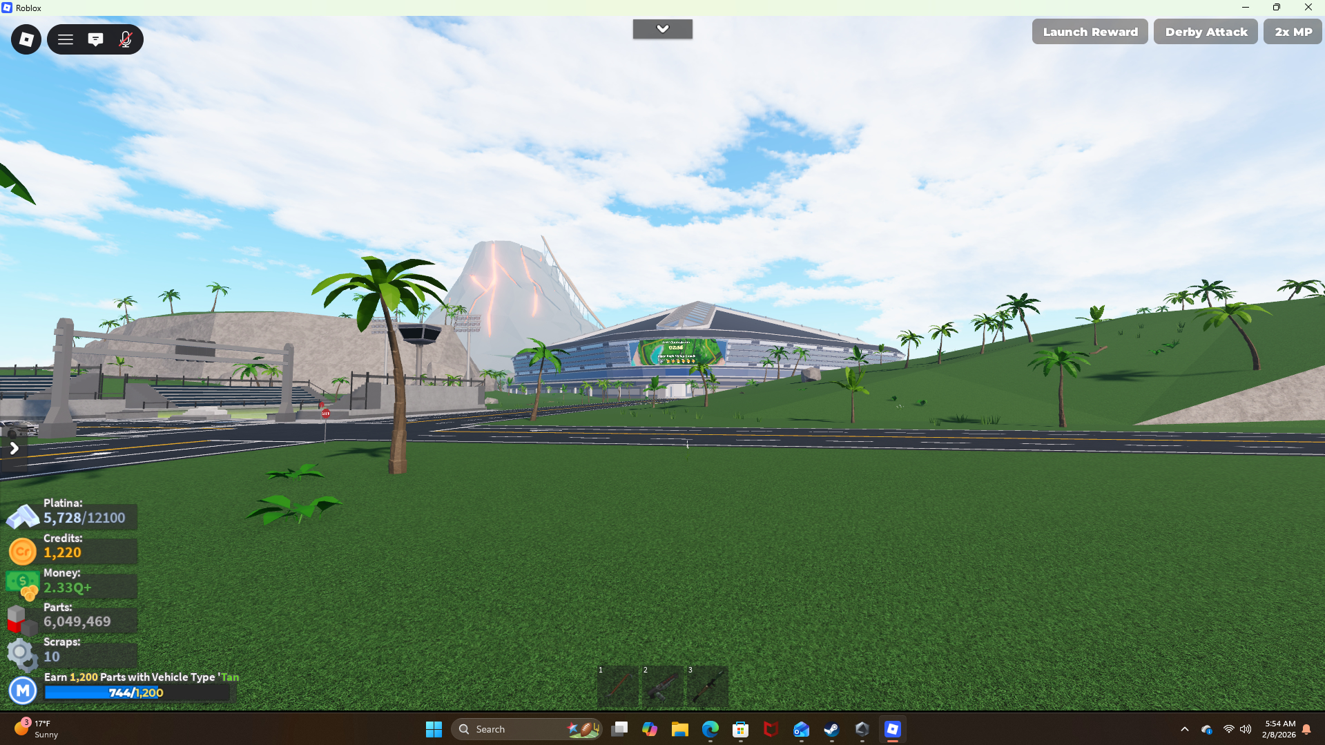

anything above a 20 series is overkill for roblox…lol. heck, a good ol rx580 is overkill. I’m guessing it’s not the only thing you play though.
Surprised at the choice of AsusTek products. Get ready for some awful thermal throttling. That cpu will be fine though. AMD is generally very good about staying cool
