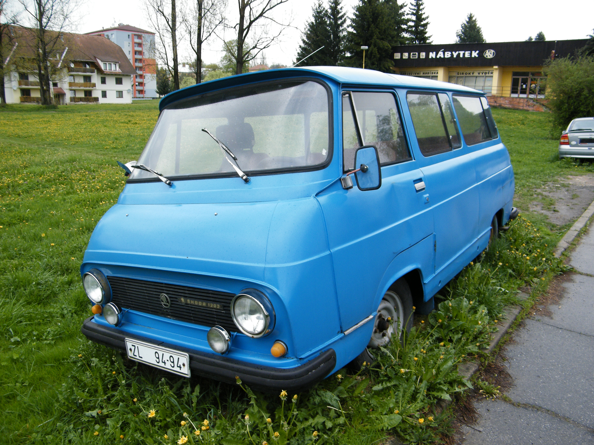

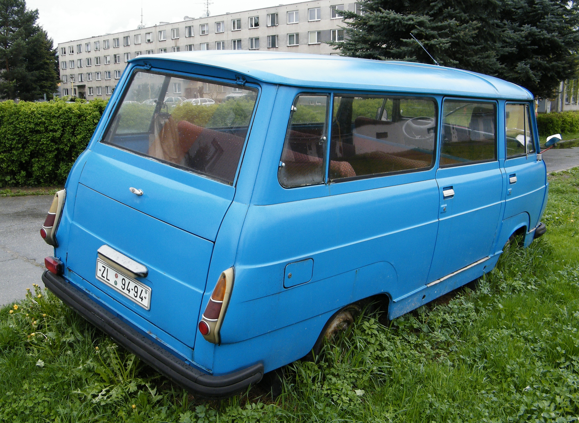

Where the wheels at
Oh mb they are there I didn’t see em
They died magically for a second
Here
some are here
