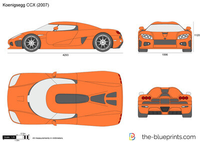

- Total length: 4293 mm (169β)
- Total width: 1996 mm (78.6β)
- Total height: 1120 mm (44.1β)
