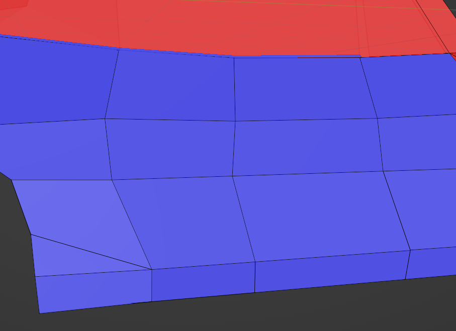

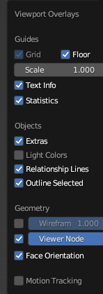

you can see it with the face orientation checkbox here

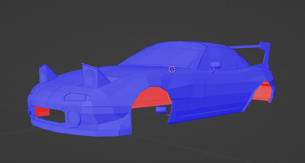

if done right your model should look like this

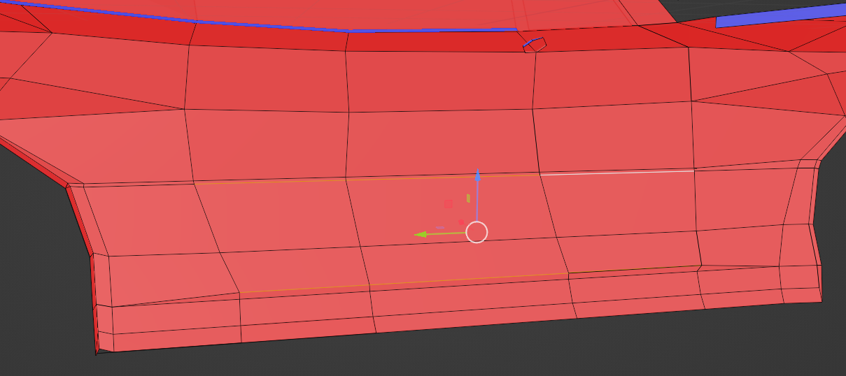

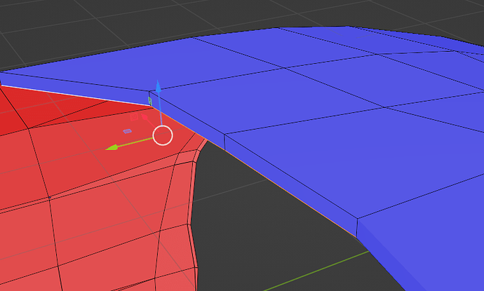

ok onto the actual solidification, personally I start by choosing every somewhat straight edge on the windshield edge here then press E+Z

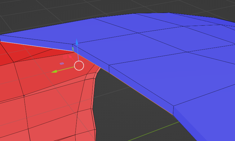

For the thickness of the solidification I’d say about this much should be your thickness of the parts as it’s mostly accurate to what the panels are in cc2

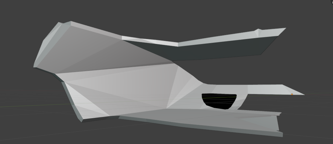

For simplification and to save on tris you should simplify the inside (got this tip from totemoyoi) rather than attempt to make a one to one recreation of the outside
for example this
could be simplified to this

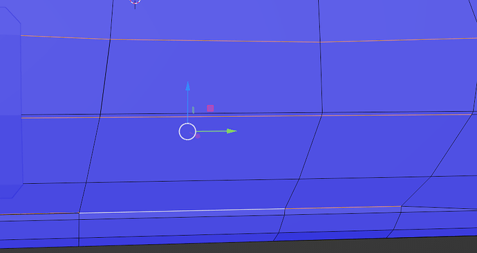

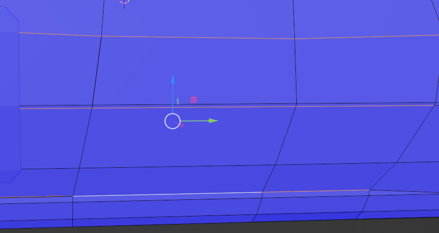

Personally I just choose every second edge on the model then press E+ (which axis makes it go inwards x or y) like this then fill in the blanks

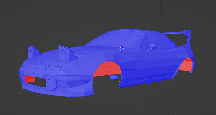

so yeah, you just do that until your entire model is blue and can’t see any more red for each part
