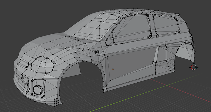

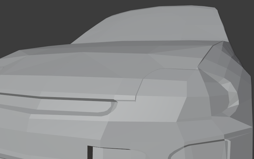

A model of a Clio V6 to try to be a modeler for CC2
A Clio V6 that I’m trying to make as quality as the cars in CC2. It has a bit more detail than the models I make.

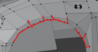

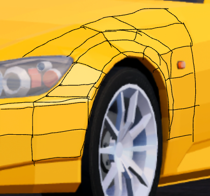

one main thing i wanna point out is the fender shouldn’t have that many sides, try to stick to 9-12 sides for them
also avoid ngons like this, try to make them multiple quads
for example the s2000:
each row of quads lines up with a side of the fender, which looks cleaner than merging multiple sides into one

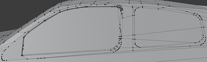

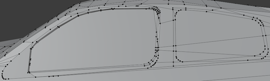

make this part more dense with quads (and make the curved parts of the window less dense, maybe 1-2 edges instead of 3)
make the topology less dense here and make it mostly quads: (9-12 sided fenders should work also)

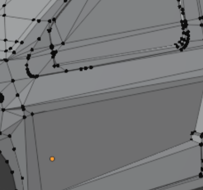

avoid vertices in the middle of quads like this (make them quads):

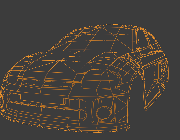

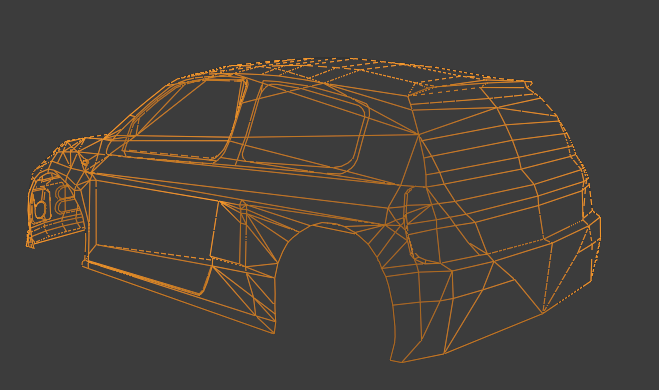

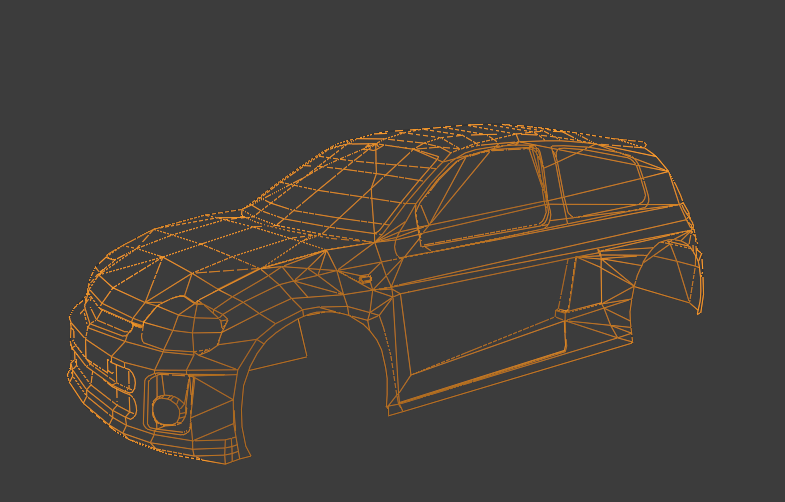

something like this?
you might wanna avoid having that many sides on fender, have one side per line of topology
